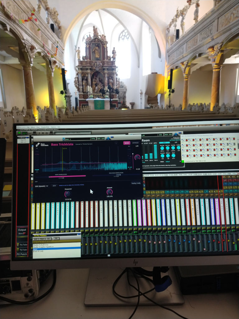

Hi,
I found this plugin
https://plugins.theta-tontechnik.de/
which claims to improve the distribution of low frequencies (no more power alley) and to reduce interference.
I've tried it in a real demanding enviroment on Saturday as plug in on the SAC output routed to the subs, and it really improves the low end.

Good find. Does it introduce any latency?

Post by TomyN »
You can change the latency settings in the plug in. There is a setting where it (and SAC64) report 0 Samples of latency.
I assume that the internal calculation will add some latency.
I've used it tow times now and did not notice any latency related problem.

Post by TomyN »
There is a section related to latency in the manual:
https://plugins.theta-tontechnik.de/plu ... v1.2.0.pdf
