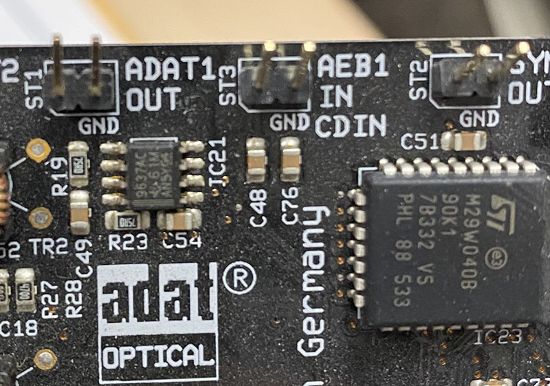

As Bob suggested if you connect the motherboard SPDIF output to the SPDIF input on the RME card, you can run anything that would normally play through OS System (YouTube, WinAmp, Footer) through your SAC/SAW channels. They will show up as the last pair of inputs on the RME ASIO channel list.
This is literally a physical connection. On my 9652 card it says AEB1 IN/CDIN. There should be a 2pin header on your motherboard that says something like SPDIF Out (Or will be listed as a numbered connector with a corresponding listing in the user guide for the motherboard).

Re: RME and Foobar
Philip,
Just for interest, I do not see those connections on the HDSP 9632.
This is what the manual states, "SPDIF - Connection to an internal CD-ROM drive with digital audio output. Allows for a direct transfer of digital audio data within the computer. Connection to SYNC OUT of another card. This internal SPDIF connection can be used to synchronize multiple cards with sample accuracy, and without the need for an external connection. The card of which SYNC OUT is used will be master, the SYNC IN one will be slave. SPDIF In / Internal has to be selected in the Settings dialog. Additionally Pref. Sync Ref has to be set to SPDIF In for this internal connection to work properly. Please note that the external SPDIF- or AES input can no longer be used."
Re: RME and Foobar
In the pictures I've see the labels are on the back side of the card. The card only has one SPDIF input so If you use select/use the internal CDROM/SPDIF input then external one is not available for use.mr_es335 wrote:Philip,
Philip G.
Philip G.
